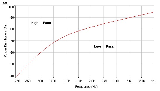

You should just consider the amount of power at the crossover input;  you really don't know how much of it is going to each driver at any time.
Power distribution, by frequency, should look like this chart shows (from Rod Elliott's ESP site):
more power/better damping if bi-amp? -- posted image.
Where, at 250 Hz the LP is getting 40% of the amplifier's available power at that frequency while the HP gets 60%.   At 3000 Hz the LP is getting 85% of the amp's available power at that frequency.  See section 7.0 Determining Power Losses
You may not be able to find what the amplifier's power output should be per frequency.
Edit:  Wait....now let me get this straight.  You said you have a filter on each driver, and each driver is driven by a channel.
So, the power is what it is per channel according to the amplifier specs.  Use that power number and scale it to the percentage shown in the chart.

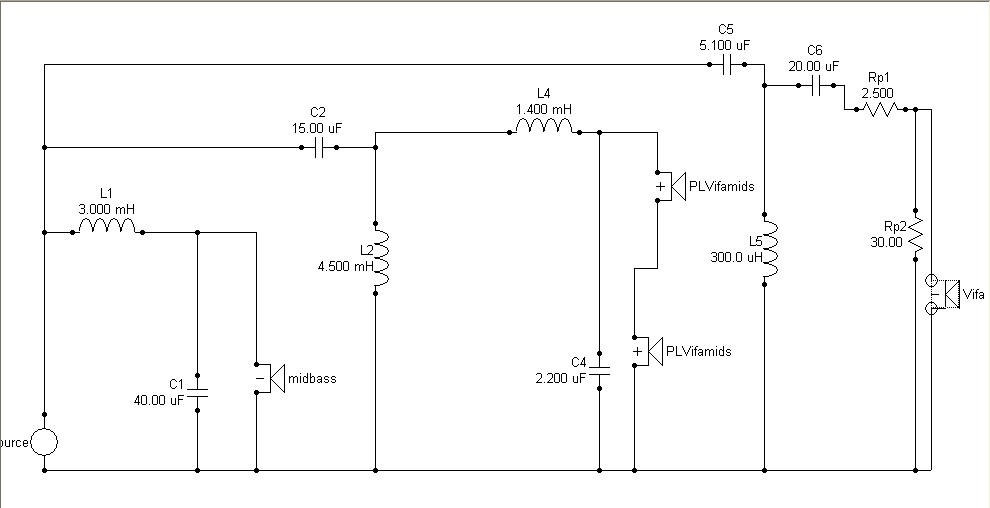

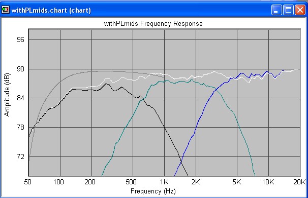

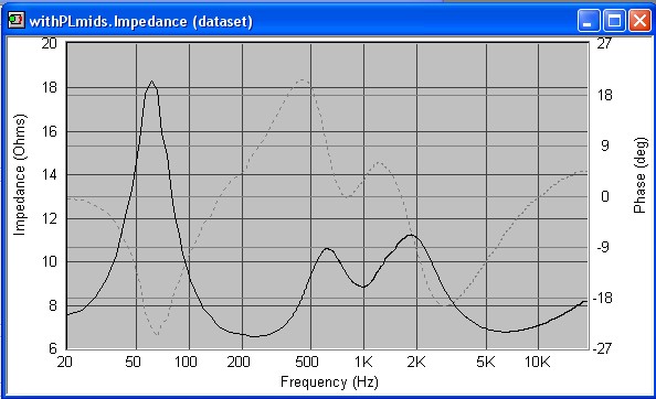

The impedance will vary throughout the freq range of each driver, so even if you have employed all drivers with 4 ohm nominal impedance, the filtered results will be ranging.  I'll post up a couple of file pics to show how impedance varies, using a crossover simulation that I've been working on for my home mains.
While this is a 3-way crossover, it can be used to illustrate what will likely occur with your setup as well.  The mids are series-wired 8 ohm drivers (16 ohms) and the tweeter is an 8 ohm nominal (5.8 Re) driver.  The low pass for the mids is a 12 db second order and the high pass for the tweeter is an 18 db 3rd order.  The actual crossover occurs at about 3100 Hz.
Looking at the response chart:  the mids are audible for a range of about 200 Hz to 7500 Hz.  Even though their nominal impedance is 16 ohms, the modeled response ranges from about 6.6 ohms to about 11.2 ohms.  The tweeter is 8 ohm nominal driver, but the response proves that it will range from 11.2 ohms to 6.8 ohms.  (Speaker Workshop is used for this modeling.)
This is all illustrative to make the point that it is not worth considering whether each driver will get more power alone on a channel than when sharing it with another driver in a different freq range.  Either way, it is nigh impossible to foretell how much power is actually going to be applied in real-life music playing.  Just consider the biamping route a plus for the additional tweaking it will enable you to do.
