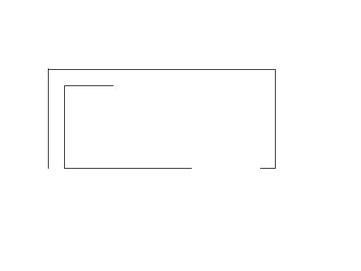

I want to make a box with a port design such as in the example below.
port design -- posted image.
Using WinISD to make sure the vent mach is appropriate, does the port size affect the sound to a noticeable degree? i.e. a narrow port versus a wider port? For example, a port 13" x 1" versus 13" x 2"? Directly related to this question, does the length of the port affect the sound to a noticeable degree? (Using the same example, 4.5" vs. 13.5"?) Perhaps a better way to put this question is: would there be a difference in the sound of a subwoofer using a port 13 x 1 x 4.5 versus 13 x 2 x 13.5 , keeping the size of the box constant?
On the same topic, how do bends in the vent affect the sound? (The picture example above versus the one below?)
I am sure there are places to find this information, I just can't seem to find them.
Thank you!

Port size, port length, box volume, and woofer's characteristics all interact to shape frequency response. Usually you start with a woofer, then thrown it's Thiele/Small parameters into a simulation program (WinISD for example) to find these measurements. It's all a product of what you want the response curve to look like. Low extension into the 20hz range, or peaky response near your car's resonant frequency for maximum SPL? High efficiency, smooth response, or some other goal? There are lots of ways to look at it.
So yes, changing the port size will make a big impact on the sound, as will changing the length. Adding bends to the line will not dramatically change the sound, so long as the surface area and total length remain the same. Just remember the volume of the port does not count towards the box's volume for tuning purposes.
For what it's worth, I think your second drawing is a better design. It's certainly easier to build, and I think it will sound better too. If the extra tail end of that post inside the box extends into the box too far, I would worry the enclosure will start acting more like two smaller chambers than one large one. This is just a guess however.

The 13 x 1 x 4.5 & 13 x 2 x 13.5 port both show the same response curve in WinISD. What I want to know is if they will actually both sound the same.
I'm torn between using a narrower port, making the port shorter (easier to build, and follows your suggestion, and makes a smaller box) and using a wider port (making it longer, harder to build, however a larger port seems to be recommended).

Okay, I see what you're saying. I misread what you wrote earlier. You're talking about a short port with less surface area, vs a longer port with more surface area. Both tuned to the same response.
The former is easier to build, takes less volume, and appears better overall. The latter will give you slower air velocity through the port, possibly reducing the wispy-breathing-sound air can make if pushed too fast through too small a port.
I'm not familiar with WinISD, but there should be a warning of some kind if you choose a port that is too small. Try, for fun, putting in really small dimensions like 1" x 1" square opening and see what happens.
I think you'll be fine with either port you have mentioned considering a 13"x1" slot has the same surface area as a 4" diameter tube. But if in doubt, go for the longer one with more surface area. You'll loose a little internal volume of the rest of the enclosure, but won't have any breathing problems and it'll sound just the same.

Of your two examples, the 13 * 2 * 13.5 is the only one that is acceptable.  Use the ratio 8:1 to consider the limit of port length to width.  A ratio of 1:1 (square) is better while an extremely narrow port is worse.  This consideration takes tuning accuracy into account.  The 13 * 1 opening is too narrow at a 13:1 ratio.
A second consideration regarding accuracy has to do with the port length.  You want the port to be long enough to allow wiggle room for both ease of build and for inherent design inaccuracies.  While it is sometimes possible to design a port at the desired tuning freq that is merely a hole cut into the MDF wall, it would be far too short for tuning accuracy.  The 13.5" length allows for more of this wiggle room than does a 4.5" length and so is the better length to use.  There is no ratio guide of box volume to port volume to follow;  the design has to be a balance of tradeoffs of overall box size and reasonable port length.
The consideration for port noise has to do with the opening area of the port.  Use the guide in the stickied threads for my comments on that.

Another reason to use a shorter VS a longer port when possible is because it affects acoustic timing (specifically group delay.)  Ports introduce a time delay to the tones coming from them, affecting the phase of the signal (introducing distortion) and can in very severe cases can result in what seems almost like an echo.  This is one reason some people think bass reflex systems sound "flabby" or less accurate than sealed systems.  It's because their port is introducing too much group delay, not because the design itself is any less accurate.

I didn't consider that as I'm not accustomed to seeing changes in group delay (with varying port lengths) using the two programs WinISD Pro and Unibox.  A port tube can certainly turn into a "pitchfork", though, if it is extraordinarily long and especially if it's not stabilized along its length.  If you are lucky enough to be able to get the port diameters "just right", there will be no bends and the port will fit easily one way through the box.  Your main consideration, however, is port noise.  The length will necessarily be what it has to be when you get the port diameter large enough to overcome noise.
