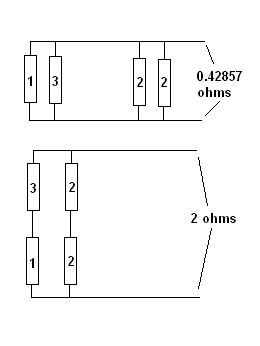

I got into and argument with my Professor at my comunity college. Talking about a parallel circuit with two legs, one leg has a 1 ohm resistor and a 3 ohm resistor and the other leg has two 2 ohm resistors. What is the total resistance and current?

  If     the 2 legs have the resistors you mentioned wired in series and then each leg paralleled, the total resistance would be 2 Ohms.  Each leg will have identical current going through them.
I can't answer how much current without knowing how much voltage is present.

Sorry 12 volts and I got a total of 6 amps with 3 amps on each leg. He said the total resistance has to be less than the lowest  individual resistor and I told him that it has to be less then the lowest legs resistance. So he said the resistance is .4 with 30 amps. I think I'm ganna just take over and start teaching the class.

Let's see if I understood.
Is it diagram A or B?
If it's A, then your teacher's right.
If it's neither, draw up a quickie in paint.

Alright My teachers an idiot. in our work book it is exactly like B. and with 12 volts am I right about the current?

Ohms law states that:
I=V/R
Thus
I=12/2
I=6 amps

Ok yea 6 amps total with 3 amps on each leg, like I said.
