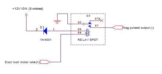

Hi, I'm looking for a way to get a negative pulse when I hit my lock button, but only when the car is off. Thanks

sorry i dont know how to edit my post, but i have 2 relays wired so far but it sends a signal when i turn my car off and i need it ot just send when i hit the lock
Relay 1
86 - ignition
85 - ground
87a - 87a of relay 2
30 - ground
Relay 2
86 - (+) lock motor wire in drivers door
85 - ground
87a - 87a of relay 1
30 - to (-) trigger input of window module

You could just wire one relay like this:
neg pulse -- posted image.
If your ignition is turned off, and you work the door locks, the relay should pulse and send your neg pulse.
If the ignition is on, the relay won't do anything if you hit the door locks.
One note on this: the switched 12V line you tap into has to be one of the higher draw lines, like the actual ignition, because this relies on it acting as a virtual ground for the relay. If it's a switched source that doesn't draw much power, it might not draw enough current to energize the relay.

Thanks a lot it works fine now.
