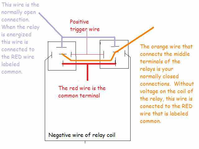

two 30a auto relays to make 60a? -- posted image.

Awesome!!!!!!! Thanks so Much!!!! To get this straight... I hook what I am controlling to the "Positive Trigger Wire" and 12v to "Common Terminal"? Just want to make sure. Thanks again!

Whatever you are controlling is to be connected to the Common (The large red wire)  The smaller wires red and black are what trips the relay and turns it on.  Anytime there is 12 volts across those wires, the large RED wire is connected to the funky colored wire at the top left of the picture.  If you conect the funky colored wire to the battery via a fuse and proper size cable, and connect the large RED wire to the device, this will work as a simple on-off switch.    If you have any more questions I will need to know what exactly you are trying to do.

Thanks. What I am trying to do is, wire a switch to the vehicle cooling fan and bypass the computer. The cars relay is bad and I do not have any money to fix it. It is a 94 Ford Taurus and I read that the fan initially (on start) draws aprox 60amps. I tried just a switch and fuse, and it pops the fuse immediatly. I read elsewhere that I need a 60a relay. Thanks again, I wouldn't be anywhere without you.
