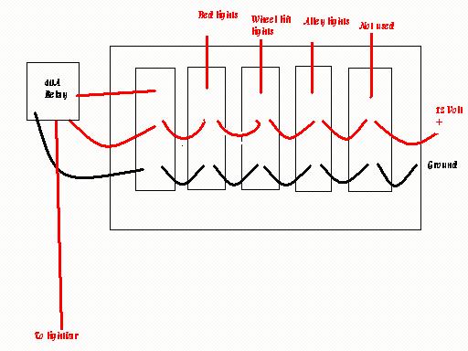

I know that it has been a while, but I finally got a chance to look at this truck and this is what I found.  The main power and ground wires are 10g.  The power wire has a 25a fuse in it.  All of the rest of the wires are 12g and the is another 25 amp fuse going to the relay.  Also the switches themselves are rated to handle 20a.  There were a couple damaged connectors in there and the switch was bad so I replaced all of that.  It seems like everything is working correctly now I just wanted to make sure this seemed like a proper wiring setup.  Also the lightbar says it should draw 17.2 amps and the alley lights should draw 12 amps.  I am not sure about the other 2 sets off work lights they are not marked.
tow truck lightbar -- posted image.

I pulled mine out, it's a southern VP, but they are all close enough. It does use one large hot and one large ground, with another 4 pairs of wires. The alley lights should not come one with the takedown lights. Some bars also have flashers.
A good switch should handle takedowns alone, then the alley lights are typically switched for each side. It wouldn't hurt anything to run a relay to protect the switch, but it shouldn't be needed. I think that says wheel lift lights. They too should be on their own switch (some states have light laws that lights that high can't be run on the street let alone facing backwards while driving.)
So your switches should be, warning lights (takedown), R alley, L alley, flood.

Excellent thank you for the info.  I wanted to run a relay just to be safe because the switches they got don't look like the best quality and the are not marked with any amperage.  They I will have to break up the 2 alley lights and run another wire.  Also I know about  not running the bed and wheel lift lights when the trucks are moving it just makes it a lot easier to get hooked up with light in both places.  Thanks again.
