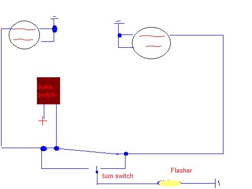

The first thing you need to do is figure out if your going to run a two or three bulb tail light. Two bulb, one dual filament (one filament handles turn and brake and the other does running lights) and a single for the back up lights. A three bulb would be easier, one bulb handles the brake, one bulb handles turn (on one filament) and running (on the other filament) and a back up.
I just drew this out quickly. I believe this is the way it works.brake lights in an old delivery truck -- posted image.

I forgot to put in a switch for the running lights, just apply 12v.
