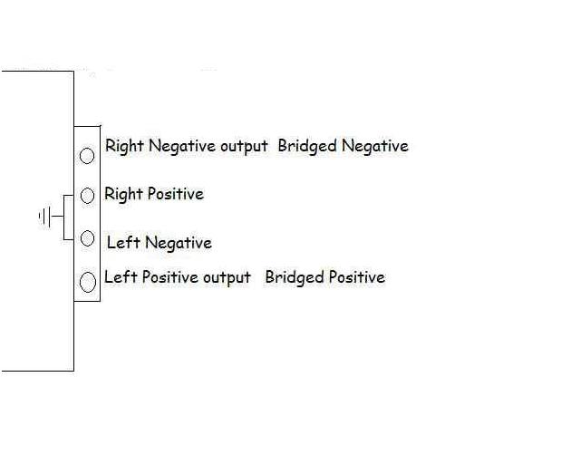

Here's the diagram...
Platinum - Posts: 13,720
Posted: July 24, 2008 at 7:15 PM / IP Logged
Following is a picture of a 2 channel bridgeable amplifier.  Notice that the left negative and the right positive terminals are connected together, and they are referenced to ground.  A 4 ohm mono load is exactly the same as a 2 ohm stereo load.  If you have a 2 ohm load on the left channel and a 2 ohm load on the right channel, it appears that you have 2 2ohm speakers wired in series which shows the amp a 4 ohm load across the bridged terminals of the amp.  When someone says you bridge your amp into a 4 ohm load and that makes it see a 2 ohm load.  They are trying to say that it will see 2 ohms per channel.
Kenwood KAC-7204 Amplifiers -- posted image.
