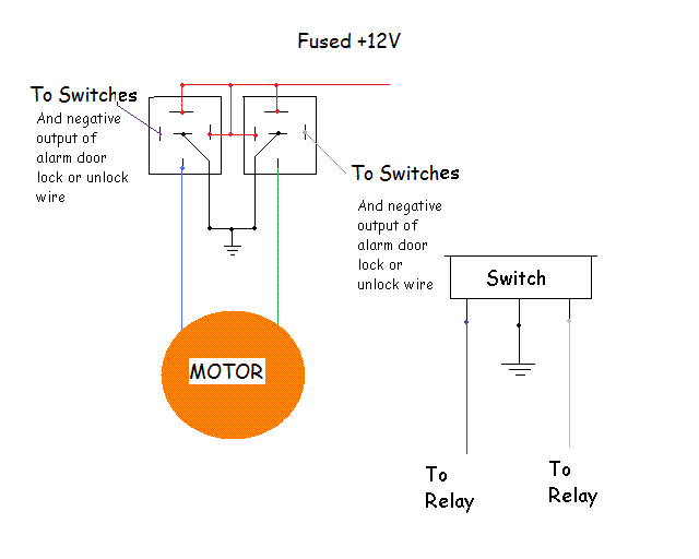

It is too early in the morning to figure your diagram out.  Do you have the rocker switch yet?  If so how much current is it capable of handling?  Following is a diagram using 2 relays, the switch can be any momentary rocker switch, it will only have to handle the current pulled by the coil of the relays.  It will last a lot longer than a switch actually supplying power to the motor.
This diagram was initially intended for door locks.  Disregard the part about the alarm connections.  You only need one switch.  It says to Switch(es).

I wish I could tell you what the A rating on the rockers is. I pulled them out of a door panel on a T-bird yesterday because they were DPDT.
I also pirated a fuse & buss box from a Ford Ranger. I kind of fell in love with this unit because it had sockets inside for 5 relays & 4 were already installed. This is what I am having to work with, unfortunately.

From my experience out in the field, I am doubting that the rocker switches can carry the current reliably over the long term.
There is always the "great unknown" (ignorance!)... what is the current capacity of a seat motor anyways? And what about the switches? Those puppies are huge!

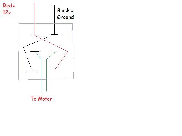

If you find out how much current the motors draw in a real world situation.  With you sitting on the seat as it moves, you may be able to use the switch for maybe the tilt function.   You may have to use a meter to verify the operation of the switch you have.  Following is a DPDT momentary switch.  I have no idea how your switch is layed out, but the picture should give you an idea of how a reversing switch is wired to achieve both directions.

Yes, I ohm'd out the switch to verify what I had in my sweaty little hand. I have an amprobe that meters DC current. I will have to check out the current draw with a load on the seat.
From what I see, it appears that I am going to have to rethink my wiring plan and pop for additional relays to remove the load from the rocker switch contacts.
I wish that the components on cars (like the rocker switch!) were labeled with specs so I would not have to post like this for help.
Okay, I am going to omit some of the seat features and double up on the relays. This will remove the load from the rocker switch and put the burden back onto the relays.
Any idea as to what size the fuse protection should be? What about wire size for the load & signal wiring?
Thanks, I appreciate your feedback.

I think a 10 Ga. wire and a 20 amp fuse should more than cover it.
