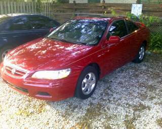

Hello everyone.  I just installed a Kenwood DDX812 stereo into my 2002 Honda Accord coupe.  Now I'm beginning to get a little paranoid that I should upgrade the stock alarm (it's a 4-cylinder 2002 honda accord ex, alarm -- posted image. EX model).  I'm trying to research possible condidates and am very confused.  I'm wondering what brands/models you guys can recommend. (??)
I'm open on features, but I would like the following:
   o ability to install now but bring car back to stock alarm easily when I sell.
   o a "soft chirp" confirmation been (nothing loud)
   o remote start capabilities (I do have an automatic... 2002 honda accord ex, alarm -- posted image. again)
   o 2-way communication so I can monitor it for a good distance.
I'd love to pay under $200 for the whole thing (w/modules needed, etc.) but will of course go higher as necessary.  This is something I plan to install myself... I've installed a few alarms and remote starts in the past.
Thanks very much for your time and any suggestions you might have!
