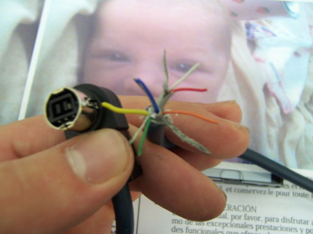

I acquired an AI-Net cable that was for a CD changer. I want to convert it to an AUX input cable for my Alpine.
https://i209.photobucket.com/albums/bb103/jmelton86/Stereo%20Junk/100_6146.jpg
Now, i'm assuming that i'd use the red and white wires for the RCA inputs' right and left positive, and the 'ground' wire (wrapped around the red and white wires) for the RCA jacks I want to solder to the cable. But, I don't want to do anything until I know for sure.
Do you think i've got it right (red and white for positives, 'ground' wire that is wrapped around them for the negative)?
Thanks, Javin.

I was given this diagram by Johnecon2001 on ROE. Red for R+, orange for L+, and white for -.
Do those colors seem right?

Since that is the only shielded PAIR of wires in the bundle, I too would assume that you are correct. You will have to solder it connect it and check it to be sure. Make sure you insulate all of the other wires, since there is Switched 12 V, Constant 12 V, and data in the same plug. The part number for the actual Alpine part is KCA-121B. $8.50 shipped to your door.

I had it upside-down. Green for R+, Blue for L+, and each has their own -.

Is that a shield wire around the RED / white wires?

Yes, although I didn't check it for continuity at the plug so I don't know what they were for -wasn't interested in them...
Well, it's installed! Works like a charm. Saved me $8.50! The green wire is left +, the blue is right +, and each have their own -, which are with each wire, in parallel at the plug. Both wires, the blue with -, and the green with -, are wrapped in foil, so that's how they are sheilded. I used Monster XLN RCA jacks (their 'higher-end', rebuildable jacks).
