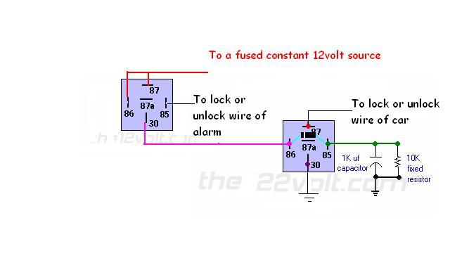

Posted: August 29, 2008 at 10:07 PM / IP Logged
Following is a diagram of what has to happen. You will have to do this twice, once for the lock wire and once for the unlock circuit. The diagram calls for a 1000 microfarad capacitor. I think you need to use a 220 or a 470 mic capacitor. The 470 should give you a quarter of a second. The 220 should give you 1/8 of a second. The item on the right relay is a diode. 1n4001 they are available at RadioShack. The diode is connected across terminals 85 and 86 of the relay. It matters which end the silver band is installed.

Posted: September 04, 2008 at 6:58 AM / IP Logged
You are right, the controller sent  too long pulses is the reason. I have changed a new one. Everything is OK. Thank you  so much.
