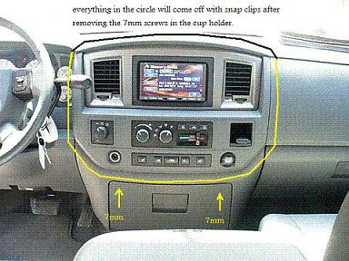

Posted: September 06, 2008 at 9:47 AM / IP Logged
The link isn't for the Dodge Ram 1500.
If you don't have the large consol between the dash and the seats on the center hump do this:
Open the cup holders and there are two 7mm screws under the top lip holding the bottom of the radio/climate control trim bezel.  Remove these first.  Then gently pry from the bottom, the entire radio trim/climate control assembly.  The two air vents to the left and right of the radio come off WITH the bezel.dodge ram 1500 radio removal -- posted image.
