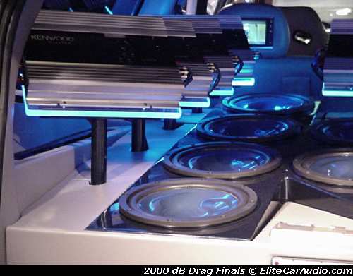

can someone explain exactly how to do this.
do you put the tubes or leds on the edge or under the plexi?sand the edges? and does it mater the tickness of the plexi? i was planning on 1/4 or 3/8 ..
please someone explain
thank youlighting plexi up? -- posted image.

I just did this yesterday.  I took 4 LED's and drilled them into one edge of 1/2" plexi.  The edges of the plexi were 'frosted' by sanding them so that they were smooth but not transparent.  When they light up, all the edges light up.  They will show any scratches on the top and bottom of the plexi, so you have to be careful.
