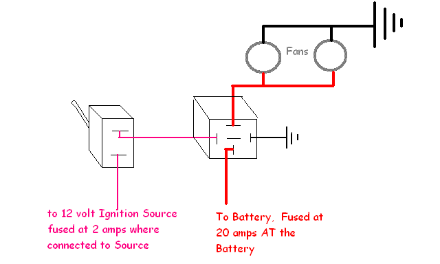

Thanks for the info.......Can anyone put a couple of diags together, to do the following:
1. Power up the fans when ignition is switched on
2. Power up fans when Ign is on, BUT, also provide an override switch to switch them on/off at will whilst Ign is on.
Would be much appreciated.
Thanks
Graeme
Platinum - Posts: 13,726
Posted: September 19, 2008 at 4:24 AM / IP Logged
fans, relays, fuses -- posted image.

Cheers bud, thats awesome, just what I was looking for :-)

General rule of thumb is to only load a fuse to 75% so I would recomend a 20A fuse.  Also, as mentioned above the fans will pull quite a bit of current at start up, I would suggust using a PAC TR-7 to add a 5-6 second delay before the second fan kicks on.
You could also replace the ignition controlled relay with a frequency switch hooked to either a fuel injector of a coil - thus only having the fans come on with the actual motor is running (I'm assuming the fans are engine related).  You could also use the toggle over ride switch with this set up.
