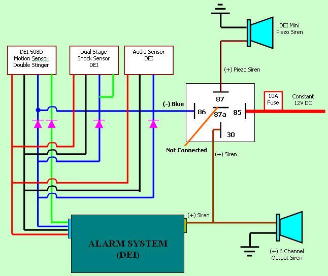

Good Day Guys!
Please see drawing for more detail.
Question: Is the diagram ok? Will it not make any harm to my vehicle?
I want piezo siren to be activated only during FULL ALARM, but in warn away only the 6 Channel Siren will sound.
Please help! Thank you!

Guys!
Forgot to tell why I'm doing this.
Reason is that everytime I Lock my car (Mitsubishi Galant 04) the Siren will chirp so the Piezo Siren(I wired the 6 channel siren with the piezo without any interface). Since I have a Audio Sensor inside of my car, it picks up the sound of the piezo siren. When this happen, a bypass chirp will be heard.
Another reason, When the warn away Motion sensor is activated, Piezo siren and 6 Channel siren will sound also.Audio sensor pick this up and gives me a false full alarm on my 2 way lcd remote.
Hope to hear from anyone. Thank you!

Posted: September 18, 2008 at 6:06 PM / IP Logged
