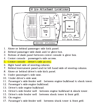

I am searching for the location of VSS wire in my car so taht I can tap it the Rostra Cruise control I am putting in. The Rostra manual says for my car it is "Location 5 Fuse/Relay Box 2nd row 13 pin". but it doesn't tell me where to look for this "Fuse/ Relay Box". I am confused between the two boxes, one under hood ( near the battery) and other under steering column ( inside the compartment).
If some one knows about this delima, please reply back. Also would be nice if you can post sketch/photos.

Your answer is in your question... Location 5.

Thanks for replying. But I have this schematic from Rostra and spent afternoon looking for Blue/White wire at said location.  Found Pin#13 on the second row, but it  had 15Amp fuse. I wan't sure if they want me to insert the wire into the fuse to tap, so I used multimeter to see if Pin#13 shows pulses as I drive around. It didn't. So I am back to square one.
If you have picture or sketch of the wire connector ... that would be very helpful. I have rest of the mechanical portion done but this silly VSS wire is bother me. Any help would be appreciated.
