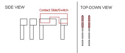

This switch has 3 positions, this is a drawing of what the switch looks like inside, the red portion is the slide that makes the connections.
Im not sure what type of switch this is or if i can even find something to replace it that ISN'T PCB mounted.
any help would be appreciated.

You will have to remove the switch and use some small ribbon cable to extend the switch to wherever you want to install it.
It is a double pole triple throw switch. It is used for a crossover selector switch, One position for each, full range, high pass and low pass.

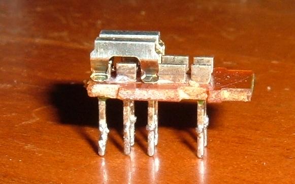

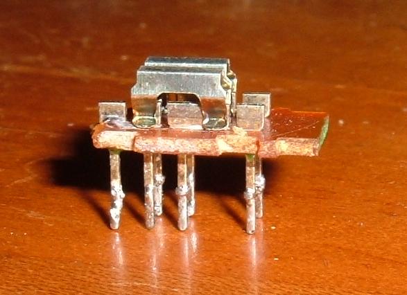

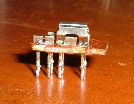

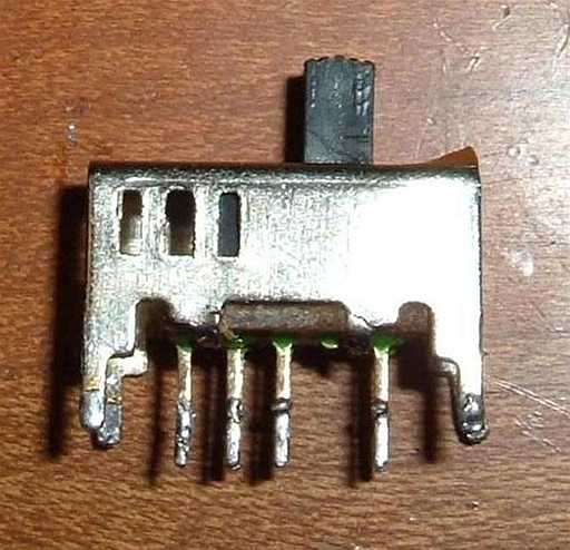

Here are actual pics of it.
Assembled, position 1, 2 and 3.

They call those DP3T switches.
They have a few on Digikey.com - here is one that looks promising:( http://search.digikey.com/scripts/DkSearch/dksus.dll?Detail?name=679-1228-ND)
You will just to verify in the datasheet that it switches the exact same way (ie one in per side and three outs per side).
Kevin Pierson
