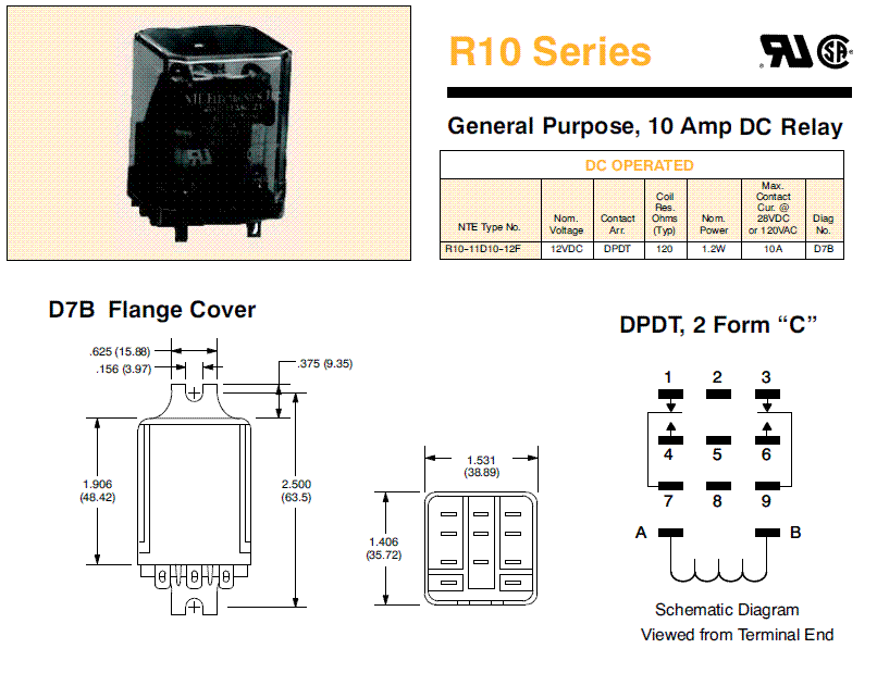

NTE Bought ECG
Replace ECG part# RLY1942F With NTE part# R10-11D10-12F
here is the Datasheet
http://www.nteinc.com/relay_web/pdf/R10.pdf
Here is a mini Datasheet I made from the original for your relay.

dstrick32
Joined: October 28, 2008
Posted: October 31, 2008 at 9:41 PM / IP Logged
relay, philips ecg rly1942f -- posted image.
A & B Coil = 85 & 30
7 & 9 Power sources = 86
1 & 4, 3 & 6 Accessories = 87 & 87A
Am I anywhere close to being right??
Thanks for the diagrams.

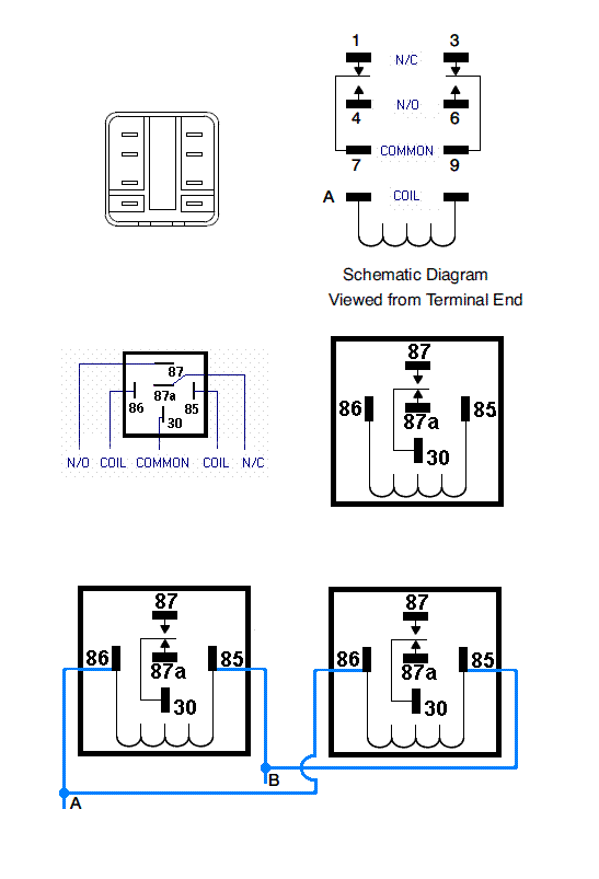

Platinum - Posts: 13,725
Posted: October 31, 2008 at 9:47 PM / IP Logged
A and B = Coil = 85 and 86
7 = 30
1 = 87A
4 = 87
9 = 30
3 = 87A
6 = 87

hotwaterwizard
Silver - Posts: 1,350
Joined: December 11, 2003
Posted: November 01, 2008 at 1:51 AM / IP Logged
You nailed it !
Here is a comparison of the 2 circuits.
