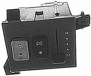

the problem has nothing to do with the park light circuit on your remote start or the installation as it works when the unit arms/disarms. you have obviously tied into the system AFTER the fuse box. thus the reason they still flash with the remote start even with a blown fuse in the fuse box. that also tells you that nothing after the fuse box is shorted. you have a short inside the headlight switch. is your headlight switch the square one with a seperate button for headlights and parklights and has a slider off to the side for dimming the dash lights?

Yes Ckeeler it is as you described. 1 square button for parking lights 1 square for head lights, and a slider to set how bright the dash lights are.
When the fuse blows the dash lights also go out. Everything works fine till I turn on the parking lights, As soon as I hit that button the fuse blows.
So should I remove this and trace that wire back to see where its spliced into the brain at? Is my short on this wire? Can I test it with my voltage meter to prove the short? I am going to stop on the way home to buy a headlight bulb to try the suggestion up above.

no, you have to change that switch. its bad. it has an internal short. thats all your problem is and all you need to do is replace the switch

its just called a headlight switch assy. it will be the headlight button/parklight button/slider all in one unit, just like you have now. the CARQUEST part number for a new one is DS655. looks like this
