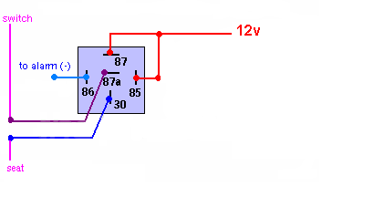

thats how i would do it. i would also wire them like this.
relay for heated seats -- posted image.
How would I need to wire it up for two seats? Would I need to diode isolate? if so, how would it be wired.
Also would I be able to wire it up so that the heated seats would automatically come on when the car is remote started?
IF you were going to wire it like this for 2 seats, you would need 2 relays. one for each seat. you can wire them to be on every time you use the remote starter if thats how you want it, although its much nicer to be able to turn them on when you choose.
