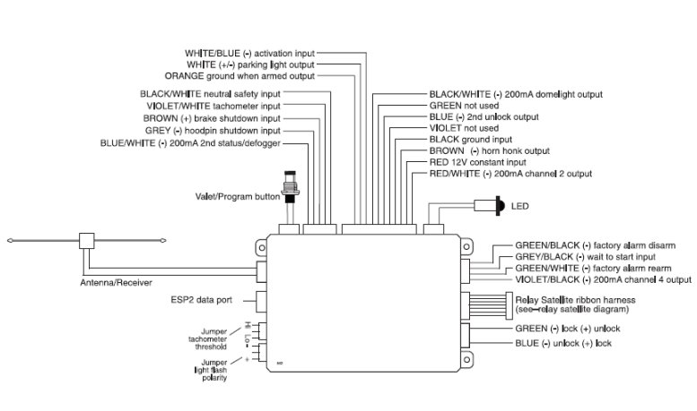

the first thing i was thinking of trying is: remove the battery from the remote, then unplug only the antenna from the brain for 10-15 seconds, then plug it back in and reinstall the battery in the transmitter.
w_huisman
Member - Posts: 14
Joined: November 05, 2008
Location: Iowa, United States
Posted: November 07, 2008 at 9:04 AM / IP Logged
Alrighty. I'll give it a go. Looks like the top connector on the left side in this pic..

FIXED!
I climbed under the dash and unplugged the antennae from the brain. To make more room for me to fit down there, I pushed in the e-brake pedal. After waiting nearly a minute, I plugged the antennae back into the brain and put the battery back into the remote. Low and behold, she started up with the remote!
So then I thought I would drive my truck back to work and the first thing I did was release the ebrake pedal. The second I did that, the truck shut down and the lights started flickering again, so I was right back to where I was before. Quite discouraging.
I climbed back down under the dash to get a better look at the ebrake assembly. There was a black wire that was getting pulled by the assembly when the ebrake was released. I found where this wire was grounded to the wall, and it had very nearly pulled out of it's crimped o-ring connector! Once I re-routed and regrounded the wire, everything is fine.
If it weren't for the fact that you encouraged me to climb under the dash to unplug the antennae from the brain, and that I pushed the ebrake pedal to make room for myself under there, I/we would still be scratchin my head on this one.
Thanks a million Keeler!
