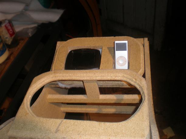

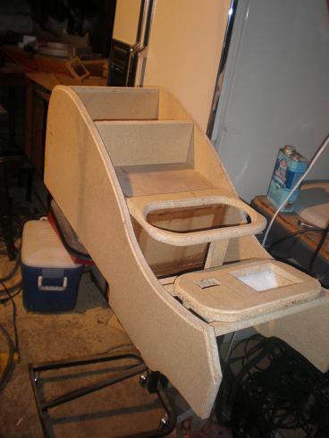

center console 05 f 150 -- posted image.
There will be a cup holder in the big oval

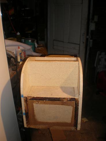

back view
front view
i will be glassing the entire thing and flushing in a remote any other ideas would be great

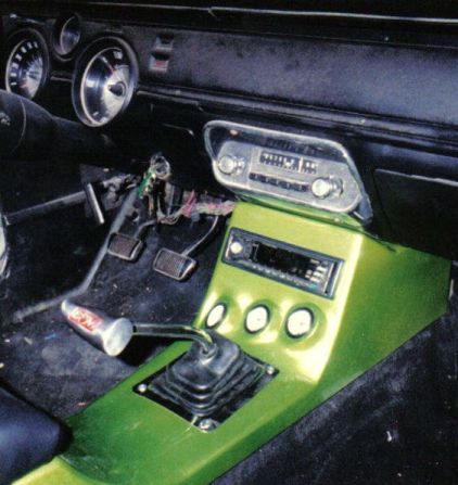

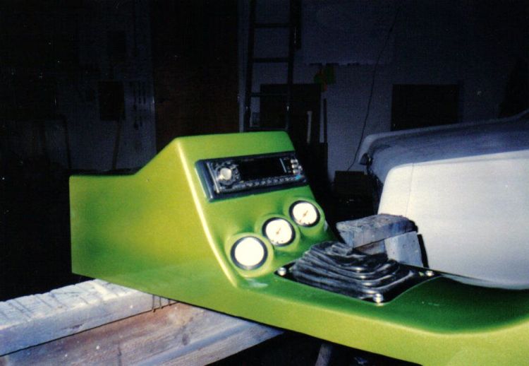

add neon. or gauges, like this

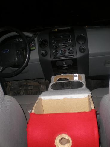

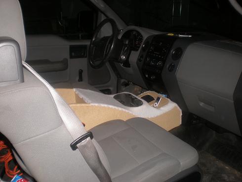

checking fitment before glass
from behind
not yet bolted down so it looks a little crooked
please any suggetions or opinions

lighting? any lighting?? some cool LED's maybe, some neon maybe.
