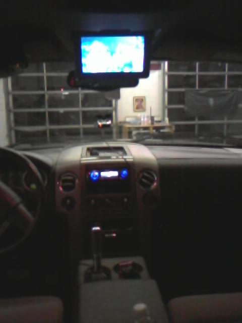

05 ford f-150, audio wires from factory dvd -- posted image.
factory headunit hidden behind dash.

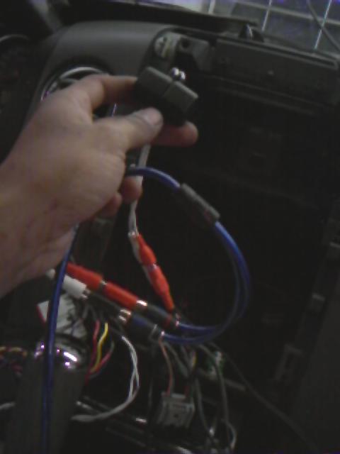

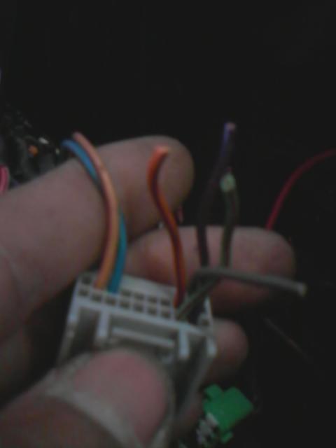

Aux plug.

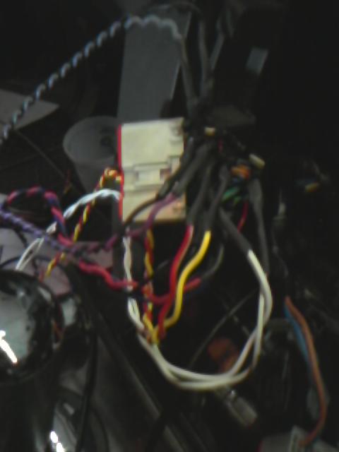

Hardwire to headunit

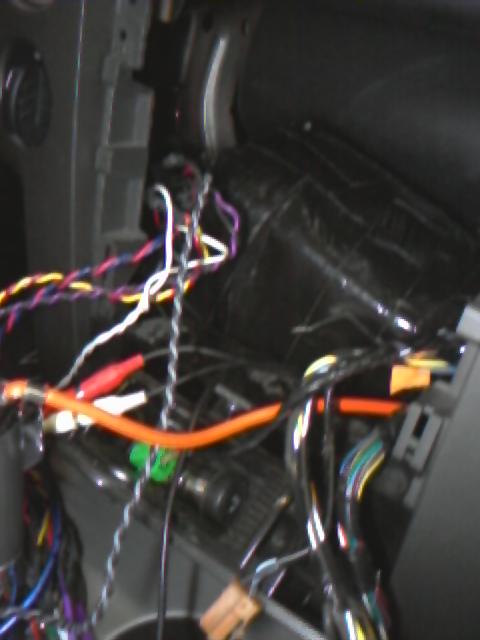

noisefilter or ground loop isolater might be a good idea
