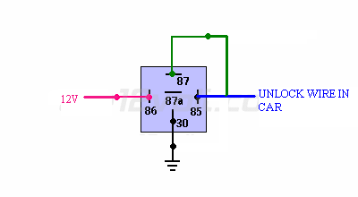

Posted: November 19, 2008 at 5:57 PM / IP Logged
do this in addition to the alarm being hooked up to the unlock wire. the time it takes to activate the relay and pulse the wire again will give you a double pulse and unlock the other three doors.

Posted: November 19, 2008 at 7:27 PM / IP Logged
There is another way, use the door switch wire instead of the key cylinder wire. Just like the old Corollas, the drawback is if you lock with the switch on the way out of the car the door won't unlock with the remote. In otherwords, in order for this to work you have to lock with the remote everytime or you will have to use the key to get in. As for the wire itself, i don't know the color but it is in the same plug as the cylinder wires and will show ground when the switch is pushed. this only requires one pulse to unlock all doors....

Posted: November 19, 2008 at 7:52 PM / IP Logged
To add to what Mike M2 said....If you also add the drivers lock lever wire to the equation. It will unlock all the doors, even if you lock the doors with the switch on the door. I haven't done an 09.... But this is how I've done the corollas for years. I'll see if I can find the wire colors for you.
