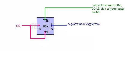

wire up the relay like this. leave all your grounds on your leds as they are and the positives that go to your switch. just add the following to what you have now.
led lights not turning off -- posted image.
