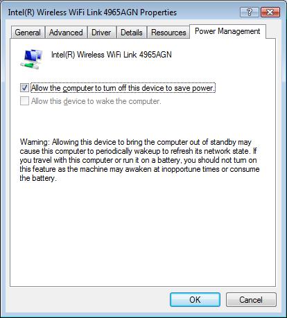

When you say it won't let you put a check in the box, where is this?  In Device manager on the power management tab of the properties applet of the wireless or ethernet?    I know you said earlier that you went into the bios and turned off all of the wake on options.   Go back there and turn them all on.  Restart and turn all off and restart again.  Now go back to wherever it would not let you put a check, see if it will now.
For my wireless adapter it won't let me check or uncheck that box. I checked then unchecked the others which didn't help.
