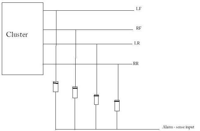

I have connected to the wires behind the cluster, and it is a quad cab truck. The problem is that it should see a ground with a door open and +12v with the door closed, and after a door closes, after a few seconds the voltage drops to +3v, which the brain sees as a ground. I've included a poorly drawn diagram as to how I've got it hooked up.

The solution to this sort of problem is well established. Check out Directed tip 1076 for a diagram.
The door triggers need to be diode isolated from the control module(the instrument cluster in the case of this post's Dodge Dakota) as well as from each other. This eliminates false grounds from a control module altogether.
