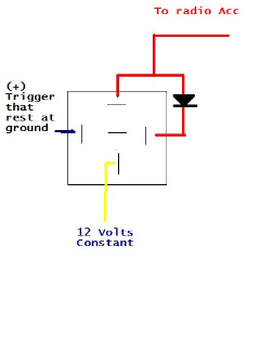

Sorry if this is a double post,  i searched and couldnt find this on the forum.
This should work on a pos door trigger that rests at ground and not open.  Another installer showed this to me, it took me a minute to wrap my brain around it but it should work.  What do you guys think.
one relay rap. -- posted image.

its already on here. whats posted though is doing it with 2 relays instead of using one and a diode.
