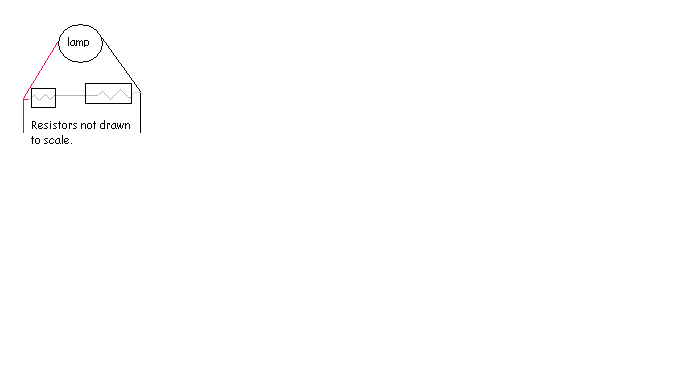

The problem is that the flasher relay of the motorcycle needs to see current draw in order to flash.  The new blinkers you installed are LEDs and they do not pull enough current for the flasher to flash.  On a car, the 8 Ohm 20 Watt resistor does the trick.  The 8 ohm resistor may be too much of a load on the system.  If you purchased 2 resistors, try running them in series with each other and parallel the light across it.  If that works, buy 2 more resistors and do the same on the other side.
flush mount blinker problem -- posted image.

i will give that a try, i did indeed buy 2 resistors. would there be a better resister for this than the one i had purchased?
Platinum - Posts: 13,724
Posted: December 07, 2008 at 9:35 PM / IP Logged
I have no idea, if it works this way and it is bright enough for you, then if you can find a 16 ohm 10 watt resistor, then that will be fine.
