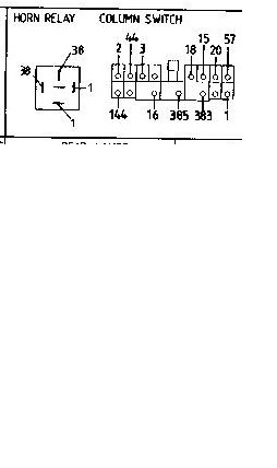

siren output as horn -- posted image.
This picture is from the factory ford manual.
And from what i can tell i don't think the alarm has a pulse single.
Thanks for your help mate
Cheers Rick

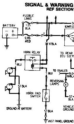

Here is the picture of the horn relay >br>siren output as horn -- posted image.

your horn is a positive system, however you need a NEGATIVE trigger to trigger the factor relay.
just take the output you have now if negative and wire it to the horn wire on the car.
