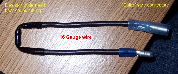

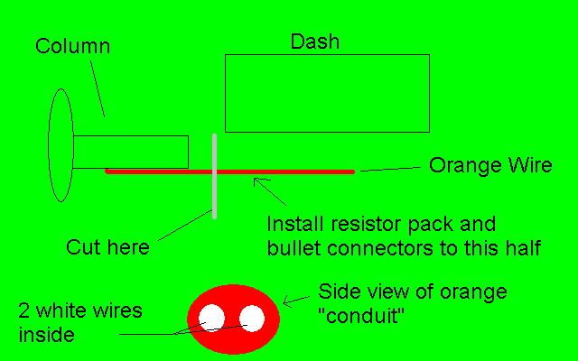

looking around online and found this. what do you think? it is totally cutting the vats out of it. I am just wondering if this will cause startability issues with the key
 ca 610 remote start -- posted image.

That's how we used to do it when Vats first came out. You measure the resistor in the key and use the appropriate resistor in the middle of that line.

You can use any 1/4 Watt resistor. You should make sure the value is as close as possible. It is best to use resistors rated with 5% tolerance. Relay is a "Single Pole Double Throw"  automotive type 30/40 amp relay with 5 pins.
I'm sure the diagram for the permanent bypass will work, but why would you want to eliminate this security feature your car already has?
