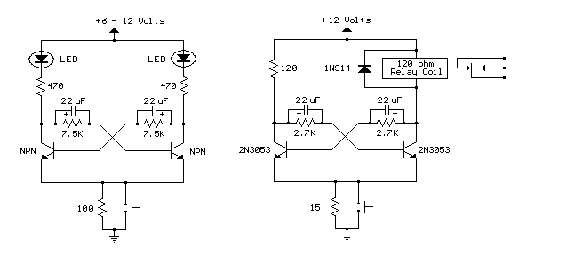

momentary to flip flop momentary -- posted image.
