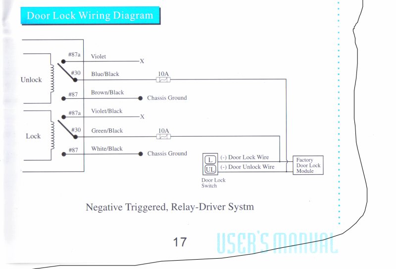

Here is the door wiring diagram from the manual.
Violet and Violet/black wires are not connected at the moment.
The others are connected as shown.
