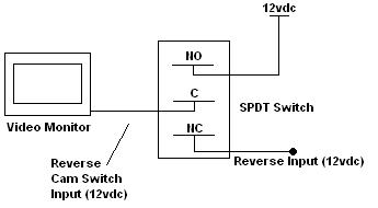

Posted: January 28, 2009 at 9:04 PM / IP Logged
DPDT Switch to Activate Backup Camera? -- posted image.
Here is a little picture.
Kevin Pierson

The camera would have to be fed power from a source other than the reverse wire.  Or it would have to be diode isolated to prevent the reverse lights from coming on when you have it switched on via your switch.  I think a DPDT switch might be necessary to power the camera and switch the deck.  Or the camera could be powered via an ignition power source, however I have no idea if this will shorten the camera's life expectancy or not.  I would power it only when in use.  I will draw a diagram and post it later.

To power the camera I would use a relay off the reverse signal.  Depending on the camera the relay may not be necesarry, but I would use one just to be safe:
Pin 85 - ground
Pin 86 - reverse signal (12vdc)
Pin 30 - fused 12vdc power
Pin 87 - camera output
I've never installed a rear camera system but I took a look at a service manual for a 2008 Infiniti G37.  They, from the factory, switch the camera on only when the car is in reverse (and they use a 6 vdc signal to do it).  I would guess there would be a very good reason for this and you most likely hit it on the head - service life of the camera.
If your camera uses very little current (under 500mA) you could technically tie it in the Common pin of the circuit I drew above.  The switch would provide isolation and you wouldn't have to worry about backfeeding the reverse lights.

if I go with the spdt switch as illustrated above, you indicate that the common (middle wire) to be connected to the reverse cam switch input (which I do not have, I have a regular monitor with RCA input), you also indicate that the "Normally Closed" circuit be connected to 12v + reverse input and the "Normally Open" to a constant 12v + source (ignition). This question might sound stupid, but where am I suppose to connect the wire that goes to the camera itself?
Maybe I wasn't clear on what I plan to do. I want to install a switch to be able to select to either use the camera automatically when I put the truck in reverse, or if I choose to turn it on while stopped at a red light to see behind me, be able to switch it to power the camera and monitor (regular monitor) to come on manually.

You should be able to easily modify the switch drawing above to make it work - just use the "common" output to power the monitor and the camera.
