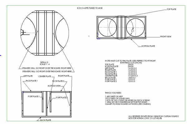

Here is a box design for 2 12"s sub system if you would like to use it
system for a 98 civic? -- posted image.
You can use is or not but it is here if you need it.

Ground must be low resistance. If you are wanting a ported enclosure do NOT buy a prefabricated enclosure. It will sound like crap.
airhed, What is the net volume and tuning of that enclosure. Not every 12" sub can perform well in the same enclosure. That is the main reason why prefab enclosures sound like poop.
