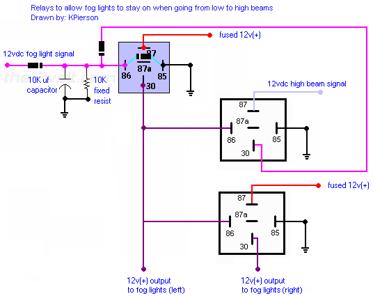

State 1: FogLamp circuit +12v signal energized, HighBeam +12v signal not energized. Fog Lights are on. When low beams are switched to High, Fog lamp circuit is de-energized via canbus, but I want the Fogs to stay on.
State 2: Fog +12v signal is not energized and HighBeam +12v is not energized. When HighBeam circuit is energized, Fog Lamps should stay off. The existing circuit is below:

What I would do is something like this:
I'm not sure if the first relay will need the cap and resistor - it is there to provide a short delay when the fog lights turn off.jeeps fog lights with canbus -- posted image.
I never built or tried this out so I can't guarentee it will work, but it's pretty basic.
If the fog lights are turned on the cap is charged up.  When the fog lights are turned off the cap will keep the relay energized for ~1 second (you can make it shorter by using a smaller cap or a smaller resistor, you probably only need a .25 second delay if any delay at all is needed).
Whenever the fog lights are turned on the coil on the "middle" relay will energize, but nothing else will happen since the high beams arn't on.
When you flip from low beams to high beams the OEM fog light output will shut off, but since the cap is charged it will cause the relay to stay energized for a brief period of time keeping the fog lights on for this brief period.  At the same time the "middle" relay will start conducting power as the high beam signal is running through it.  This high beam signal will keep the added fog light relay energized (top relay).  Since the OEM system uses two seperate relay outputs I added two independent relays for the fog lights.  Chances are you don't need two, but to line up with the OEM schematic I put two in.
Now, if no lights are on (no fogs, no lows, no highs) none of the relays will be energized.  If you immediately flip the high beams on the fogs won't turn on because the "middle" relay isn't energized.  The only way the fogs will turn on when the high beams are turned on is if the fog lights were on before the switch to high beams is made.
