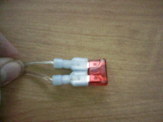

fuse size doesn't have anything to do with voltage. was that fuse blown? if so, thats your problem. or maybe there is a bad connection inside the fuse holder. you need to check these things. power problems are very simple to solve because there is only 2 things that could be the problem. either you have no power at all, this has been ruled out because the old radio powers up fine. or, there is a bad connection. and since the only difference between the new radio and the old is the wire harness. and since the wire harness is just wires except for the fuse holder then it is the obvious next step to check the fuse holder or make a new one.
you can use 2 normal size speaker connectors and a regular buss fuse and some electrical tape
it will look like this:
no power to head unit -- posted image.

thanks so much for all the replys turned out to be the fuse holder all is good now!
