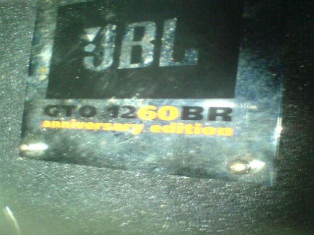

firstly, here is the 12inch sub woofer enclosure im using and its specs:
How to find 80hz on my mono amp? -- posted image.
JBL GTO-1260BR 300mm Bass-Reflex Subwoofer Box Subwoofer
GT4-12/300mm Enclosure: bass-reflex
Power handling, RMS: 250W
Power handling, Max: 1000W
Sensitivity (2.83V/1m):
92dB Frequency response: 35Hz – 200Hz
Impedance: 4 ohms
Dimensions (L x D x H):460mm x 437mm x 360mm

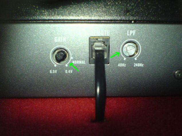

    i have it currently set up like this : ( its a very simple amp with not much tweakability )
    you can see from the photo where the knobs are currently set to by the green arrows. my thinking is that if the amp frequency starts out at 40hz,
    well then all i need is another 40hz, so i just gave a guess at this and raised the knob to where i think 80hz would be.
    am i correct in my method or completely off the mark altogether?
    where exactly would 80hz on this amp be ?
    if you know where it is, could you please save the above photo, open it up with paint, and mark where it is with a green arrow and repost.

    well since the range of that LPF is 40 to 240, difference of 200hz between all the way down and all the way up. so if you had it directly in the middle i would assume it was at 140hz. so 80hz seems like it would be just under 1/4th. from the look of your picture it is as good as you can get since all anyone can do is make an educated guess
