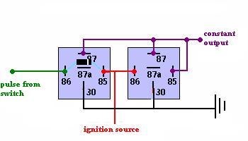

fog relay/ oem momentary switch -- posted image.
themodifier
Member - Posts: 8
Joined: February 20, 2009
Posted: March 02, 2009 at 10:32 PM / IP Logged
Thanks for the reply. Just to be clear, the purple output in your diagram is constant negative, right? If I understand, the relay on the right will stay energized until either ground or 12v(+) is removed, right? If so, I need to see if there are other options with more relays. I need to have the ability to engage and disengage the latched output with a single pulse from a switch. The first pulse from the switch will engage the latch. The next pulse from the switch will disengage the latch. If at all possible, I would prefer not to use a diode as noted in the diagram you provide. Thanks again for all the help!!

have you looked in the "relay" section at the top of the page yet? im assuming you are not getting many replies because there are already diagrams there to do just what you are wanting (provided you are willing to use 6 relays because you dont want to use any diodes). either that or purchase an electronic latching relay.
