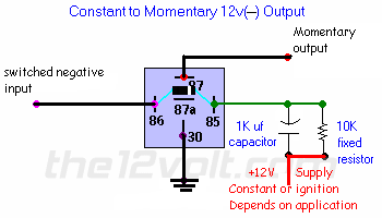

I found the relay diagram to convert constant positive to pulse, but not for a constant negative to pulse.
constant negative to pulse negative relay -- posted image.
I know that I could use 3 relays to (1) reverse polarity (2) constant pos. to pulse (3) reverse polarity again to neg.
There has to be an easier way to accomplish this. Is there a way to rewire the relay above to receive and output neg signals?

Posted: February 21, 2009 at 9:08 AM / IP Logged
Thanks!!! I will now be able to integrate this relay into my larger relay diagram for my TPS exhaust valves.
