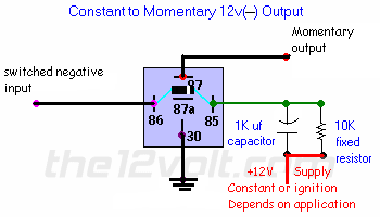

I installed a Autostart AS-1455 on my 2005 Ford F150, works great, starts and stops vehicle and locks and unlocks doors.
One little problem, when I lock the doors, I do not know if they locked since the horn does not chirp. I tried connecting a wire to the dark blue (-) wire to the lock wire from the remote (brown (-)), it works, but it sounds too long. I only want a chirp. Is there a way that I could connect the wires in this fashion, adding something between the remote signal wire (brown (-)) and the horn wire (blue (-)) to minimize the duration of the signal in order to get just a chirp?
Thank you for help, love this forum, helps me a lot.
Platinum - Posts: 13,725
Posted: March 18, 2009 at 8:00 PM / IP Logged
This is exactly what you need.  You can change the value of the capacitor to shorten or lengthen the pulse.   The diagram is good for about 1/2 second pulse.  A 470 Mic capacitor should yield 1/4 second.  330 Mic Capacitor may be more of what you are looking for.  If you need positive output for your horn, simply connect 30 to a constant 12 volt source.
horn chirp with remote door lock -- posted image.

Thanks for the response, but since my remote start wire already gives a 7/10 of a second pulse negative output, can't I just simply add the capacitor between that wire and the horn negative wire?

I'm pretty sure the only thing you can do with off-the-shelf parts like capacitors is extend the pulse, not reduce it.
A DEI 528T, or a PAC TR-7 pulse timer would probably do what you want, at additional cost.
