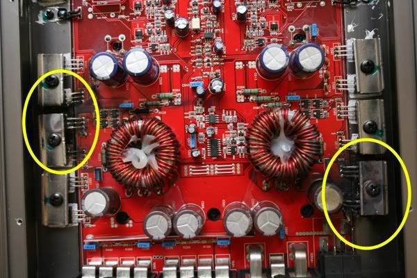

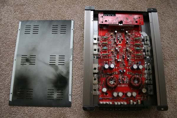

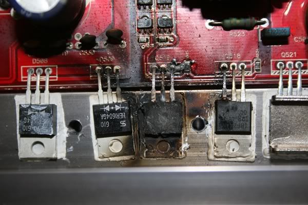

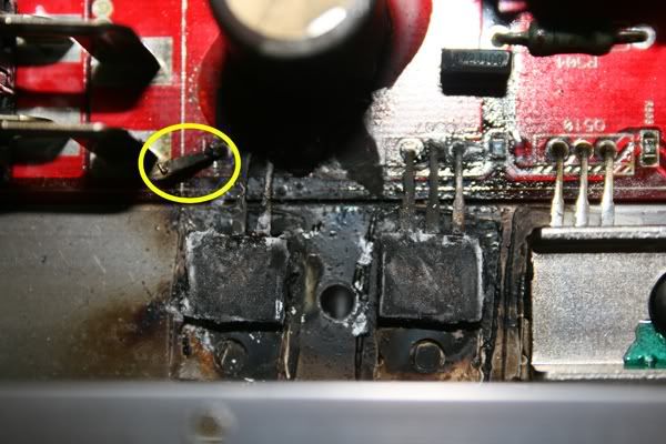

So I opened the amp up and knew immediately that I had fried it!
Notice the two large black carbon burned marks...
orion hp 4800.possibly fried? -- posted image.
Here are the other pictures... I lt looks like i burned four or five transistors.
I'm going to talk to the local Orion dealer about fixing it and the cost.
Can I get some help on how to fix it without having to send it out to Orion?

The transistors that explded are the power supply transistors. There are 4 on each side of the board.  The 2 on each side that did not explode are probably shorted too.  Even if they are OK, you really need to change them too.  They all went through the same event, if they happened to survive, there is a good chance they have been weakened.  There is a very good chance that shorted outputs caused the catastrophe.  You need to check  them, the transistors at the other end of the amp, with the large green resistors very near.  If you check them and determine they are shorted, i need to know the number on the face of them.  Also on one of the power supply transistors that did not explode, are they IRF-Z44  or 46 or 48.  I can not make out the last digit on the one you posted.  I can see at least one of the gate resistors on the power supply FETs needs to be replaced.  There is a good chance they all need replacing.  Also get some acetone and a tooth brush and get the soot off of the board.  Take another pic of the 4 surface mount transistors, 4 northeast of the east transformer.  And 4 nnorthwest of the west transformer.  They may look OK but still need to be replaced.  If you do not know how to check the transistors with a meter, let me know and I can help you with that too.
If you decide to remove any transistors from the board, DO NOT REMOVE THE SOLDER WITH A SOLDER SUCKER OR DESOLDERING BRAID.  It is easier to put more solder on each leg of the transistor and lay your soldering irom across all 3 connections and heat it up till all solder is melted, now using a pair of pliers (not for extra leverage to pull parts from board, but just to keep from burning your fingers)  gently rock the part out of the board, and then use the braid or solder sucker.
