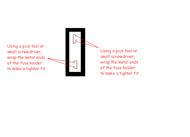

Platinum - Posts: 13,725
Posted: March 22, 2009 at 7:25 PM / IP Logged
If the fuse holder turns out being the problem, it is very easy to repair.  I will draw you a picture in a few.
amp turning on and off? -- posted image.
rocgalant
Member - Posts: 13
Joined: February 07, 2009
Posted: March 22, 2009 at 7:50 PM / IP Logged
Thanks again I am! I really hope that's the extent of the problem.
