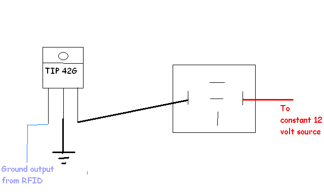

Does the RFID module supply a switched ground or positive output? If ground out, you can use the following diagram. The transistor is available from RadioShack for $1.59
proper type of relay for this -- posted image.
If the module provides a positive output, purchase One of these instead. and let me know. I will have to get you a new picture.
