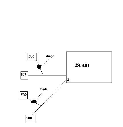

Zone 4 and 7 are used for extra sensors and can be configured to show the appropriate sensor on the LCD screen. You need to use a Bitwriter programming tool to configure the display. I suggest you put the 507 and 508 into ports 4 and 7 individually. The 508 will false on occasion so connecting it to it's own port will aid in troubleshooting and allow you to bypass the zone when arming with the remote .
The 506 and 509 use a single wire output for connection to the security system. Diode isolate the two then connect them to the H1/7 blue zone 1 wire.

viscid240
Joined: March 24, 2009
Posted: March 25, 2009 at 3:11 PM / IP Logged
would it look something like this?
python 902, '97 240sx -- posted image.
