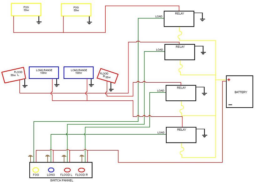

Here is a diagram I made and I would be using the supplied relays that came with each set of lights. I would like both Fog lights to be on one switch, the two long range on one switch and the left and right flood lights on separate switche

2001 nissan frontier aux lighting -- posted image.
Platinum - Posts: 13,725
Posted: March 17, 2009 at 8:10 PM / IP Logged
You need to place the fuse holders as near the battery as possible.  You may want to connect the switches to a switched power source so you do not run the battery down if you forget to turn them off.     Other than that, it all looks good to me.

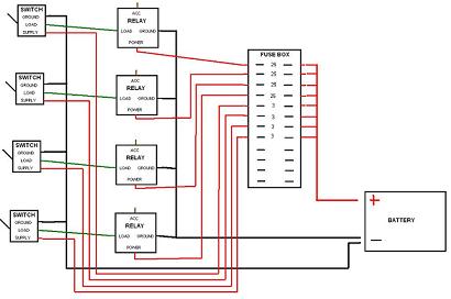

Here is a diagram. I want to wire the fogs by themselves, the long range by themselves and the each flood separately. I'll be using 10 AWG and 12 AWG wire and fuse and relay boxes.
Total wattage is 420/12 volt system= 35amps. I have an amp and a CB in the truck as well. Will the stock alternator work or will I need to go with something with more amps. If I'm not mistaken I believe the Nissans have an 80amp alt.
Has anyone purchased a HL62942 ATC Fuse Box? I need some help in running the power from the battery to the block. There is no main terminal and I would like to run one main wire and branch off that to provide the power for each of the circuits.

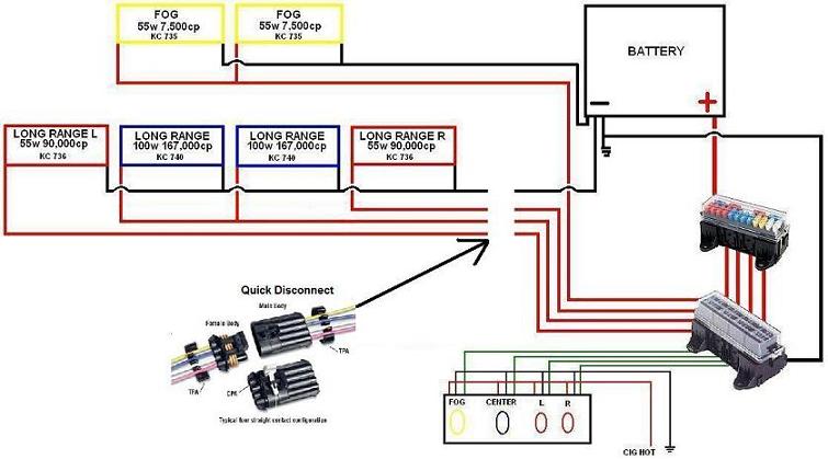

I know it's crude but what do you think of this? Also, what would be the best way to run the power to all the positive sides on the fuse box?
Posted: March 27, 2009 at 7:45 PM / IP Logged
You could use your amplifier cable from the battery, split it at  a distribution box, eg Stinger to feed your 12 outputs as fusebox inputs. Here's another wiring thought. ground to switch to 85,  power from fusebox  to 30 and 86, output to an LED and the light. This keeps your switch wiring thinner and you can use lower rated switches. Also keep those fuse and relay boxes inside the vehicle to avoid corrosion. Do like the relay box, haven't seen it here, what's the source?
