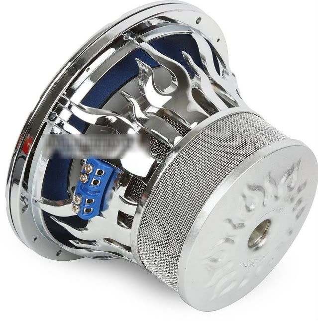

Thanx, But the thing is i have only the one sub. not 2  .  unless im not understanding the total picture here?  but the connections on the sub have the 2 positives connections side by side. and  the negatives side by side.  and the same thing on the other side of the sub.

You very well may be bottoming out the sub. A subsonic filter is needed with a vented enclosure. The sub is mechanicaly unloaded under the tuning frequency. Set a subsonic crossover at or just below the FB(tuning frequency of the enclosure). Also you have 2 spots per sides for positive and neg but, this is for ease of installation. The 2 positives and negs you see in the picture below of your sub still only work one coil. So it really only has 1 pos and neg per side.
