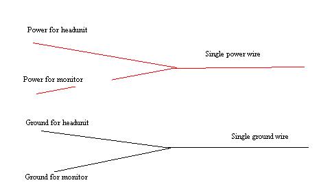

I am currently in the progress of adding an indash monitor to my car alongside my Headunit.
I wanted to ask if there would be any issues caused by splicing it into the same power and ground wires currently connected to my head unit?
I have tried searching through the forum for the answer to this, but I could not find anything.
Both headunit and monitor have fuses on their power lines, is this enough to protect them?
Also, if I connect both the head unit and monitor to the same ground wire will I get noise/interference?
Basic picture of what I mean:
shared power , ground wire -- posted image.

No, you'll be fine.

So there wont be a ground loop caused by having the two grounds connected?

No. That's not what a ground loop is. A ground loop is caused when there is a lower return resistance between electronic devices OVER THE SIGNAL cable, causing the introduction of noise. You aren't doing anything remotely close to anything that could cause a ground loop. You are creating a STAR ground, and is preferred to multiple grounding points.
