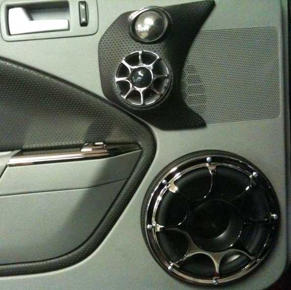

I have an 09' Mustang GT with a Morel Elate 9 3-way setup pouring out nothing but sonic nirvana.
I highly recommend the Elate 9 over the Elate 6. 05 GT's and up already have the 8 inch cutouts in both doors, Might as well make the absolute best use of the availabe realestate and the much deeper, harder hitting midbass of the Elate 9" woofer over the Elate 6.5" woofer.
I would also recommend that you keep the tweeter close to the midrange. A custom pod in the factory 5x7 door location would do the Morel Elate 9 - 4" midrange and the accompanying tweeter much justice.
With a well set up Morel Elate 9 3way setup up front, fed by a good quality amplifier, say 150 watts rms per channel, one wouldn't need any rear fill speakers.tweeter location for '09 mustang -- posted image.

Look at those sexy grills..... I LIKE IT!tweeter location for '09 mustang -- posted image.

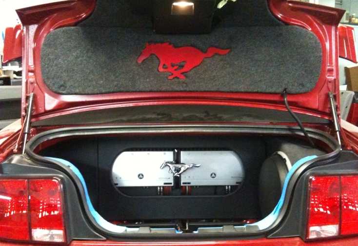

Velocity, what head unit and amplifier combination were you feeding your Morel Elate 6 3way setup in your truck? This is my first stereo install and I'm hoping I chose decent electronics to compliment the Morel Elate 9's.
For a head unit, I decided to install Eclipse's new AVN 726E  unit (5v preout) , amplified by a JL Audio Slash 300/2 V2. I decided to go with an All JL Audio setup out back since they make a killer stealthbox for 05-09 Mustangs, cradling a robust 13.5 W6 V2 Sub, tucked neatly against my rear right wheel well, which  gave me the room I needed to  install a 10lb NOS bottle with all the trimmings.
She's still under construction, I'll post more pics when the install is complete.
